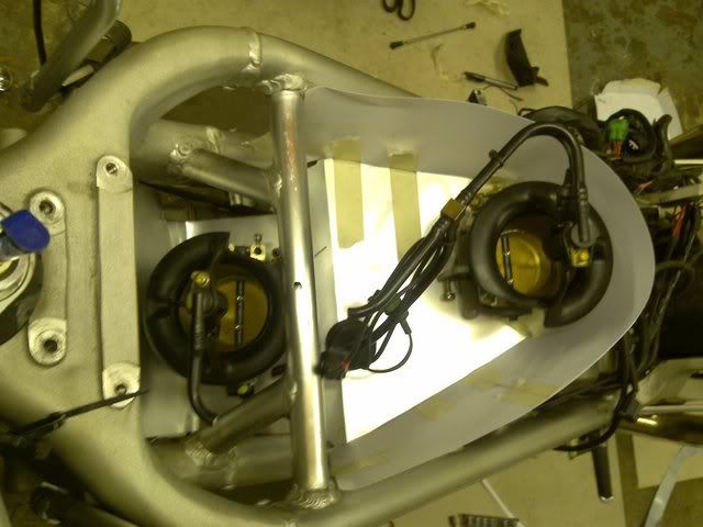

been doing something down the garage might even get it finished for summer
started to strip it to get frame and stuff power coated then decided to try something thats been on my mind for a while

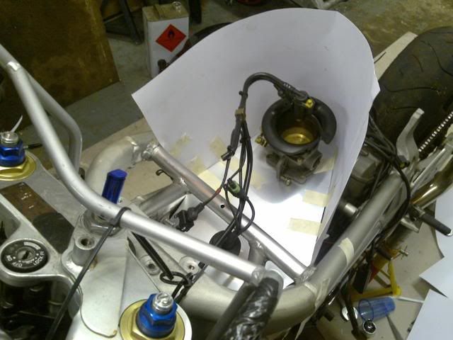

looks like they fit in there quite nicely and now for the air box
that took me quite a while to rig up will have a go at the rest tomorrow:devious
877 Posts
Nice.Will this be a new airbox?
301 Posts
yep

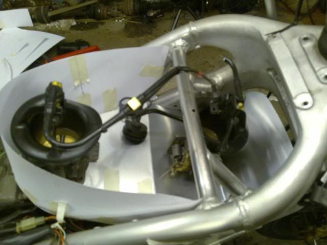

new airbox with a complete new snorkel feed through the front of the side spars
its not a complete one piece box as the cross bar gets in the way
so im taking insperation from a development photo i saw a while back
of a norton rotary with its cobbled together airbox all made of seperate pieces
what you see in the photo is the bottom half not quite finished
with the tank being used as the lid for the airbox

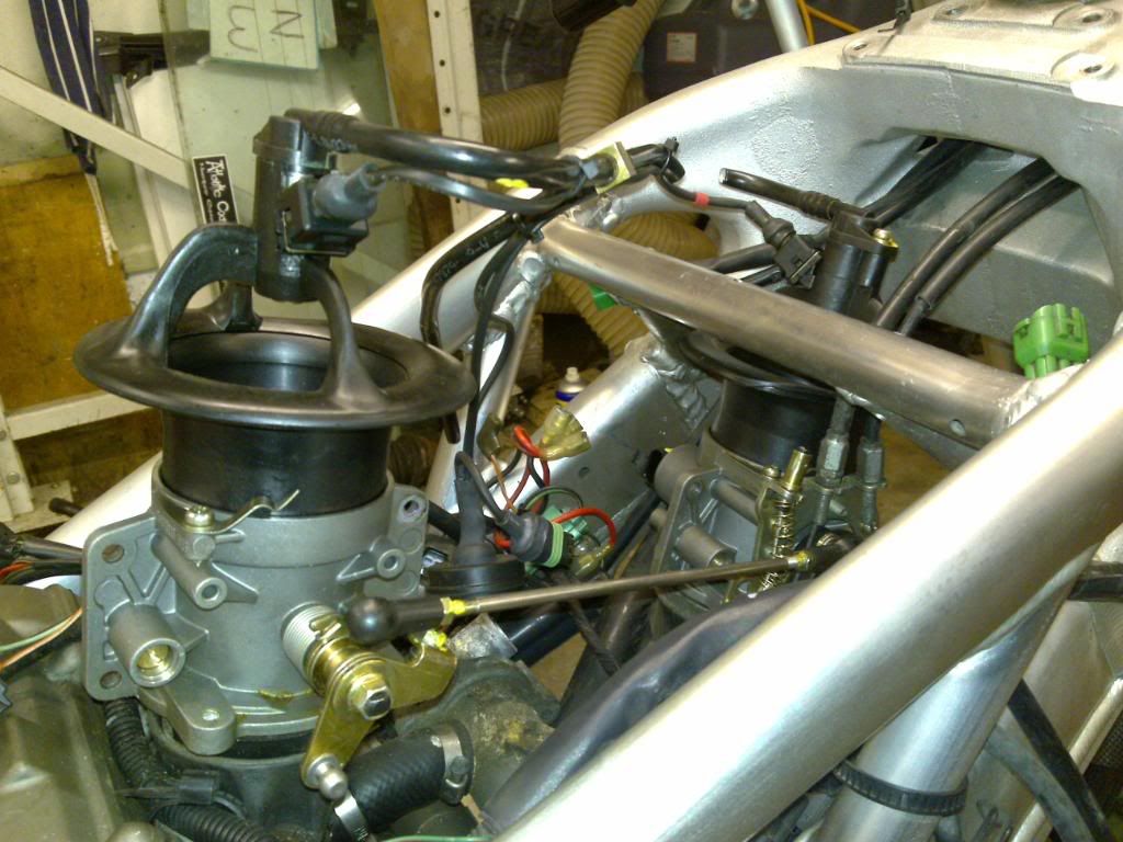

right now im using ducati 749/999 54mm throttle bodies with 749s injectors
probably wont deliver enough fuel at full chat but will upgrade if needed:devious

You could use carbon fibre or polyester to form the shape you want.

yep bottom may well be made from carbon as i have plenty sitting in the garage
thought about vacuum forming the lid from tank

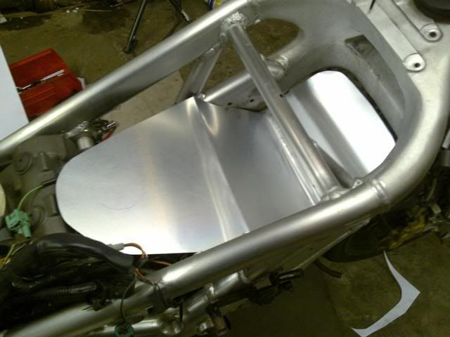

so started on the airbox needed to fill it so i could take a mould from it
