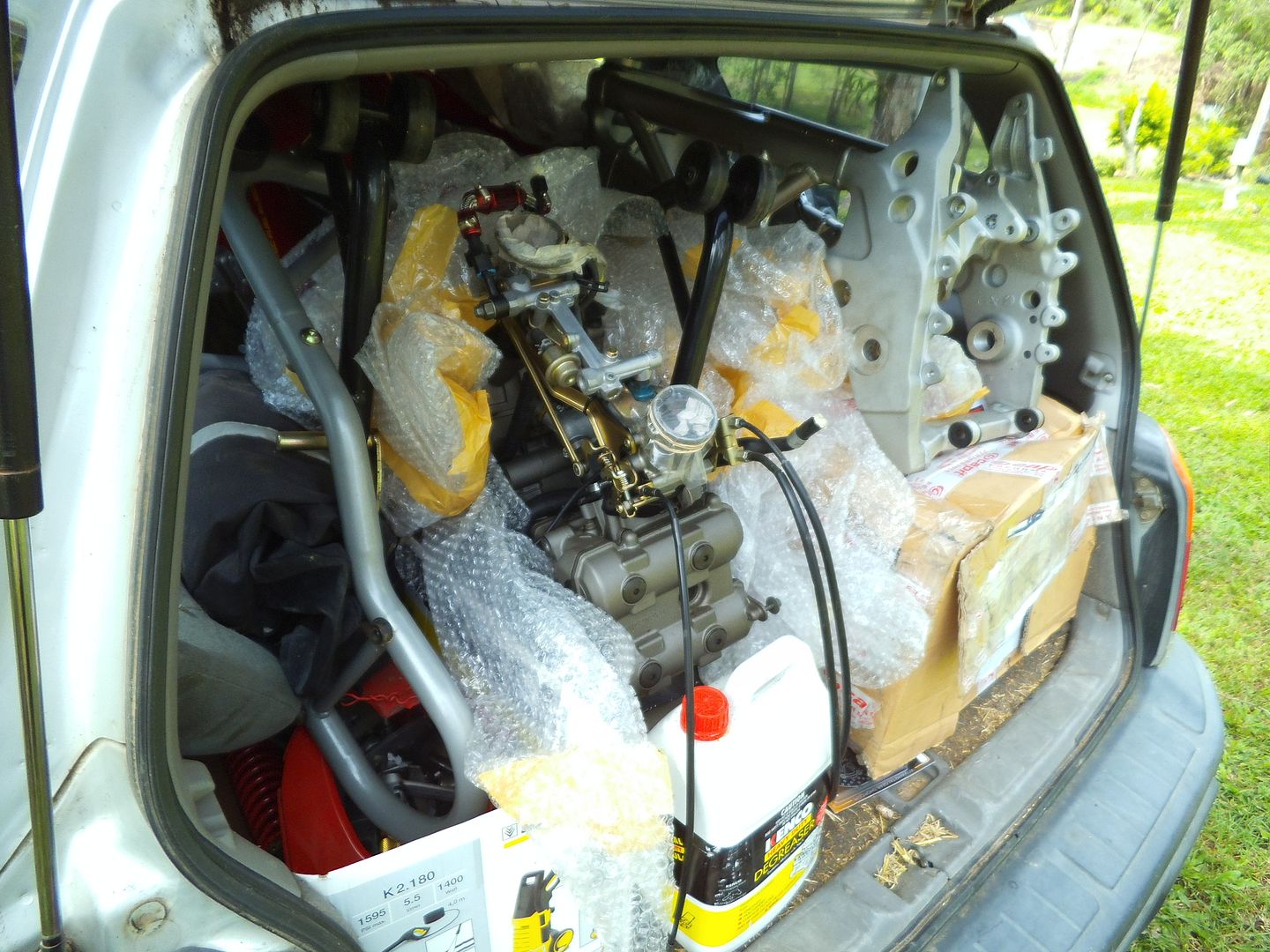

Considering I had no idea what I paid $1000 for I am well pleased (an understatement )
http://i1123.photobucket.com/albums/l552/gus2203/DSCF5004_zps345fc6c0.jpg
Wow, it's even really CLEAN!
