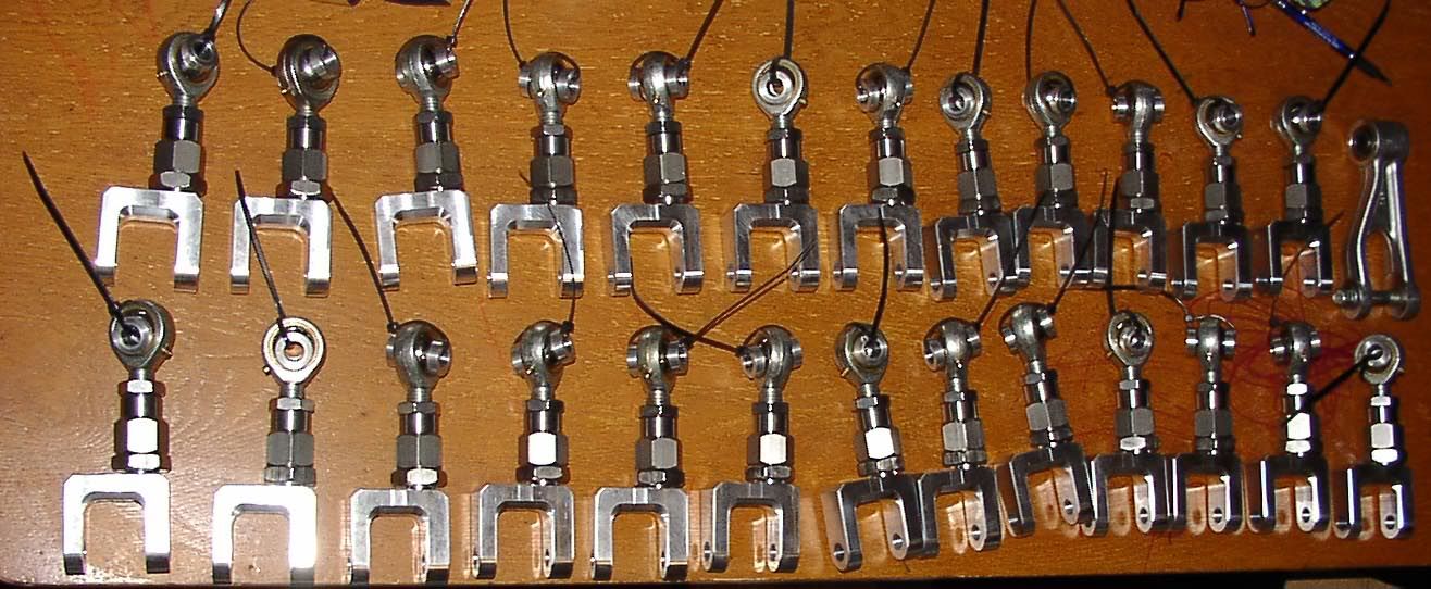

Please can someone either post or PM me with the RHA Dimensions. This can be ziggys or the crappy copy on ebay, doesn't matter. As soon as I have all the dimensions, hole sizes and thread length etc... I can start work on designing and making a Billet RHA for the TLS (adjustment without taking bolts out) . As these are few and far between, its prob a good idea for one of us to start making them again.:D

Mine is mounted on my TL. IIRC the picture was from Sam.

That's a good design.I have had one like that for the past 14 years on my S. Never had a prob with it.Still going strong.
:) Back then it was made by Vee Two Australia :hail
