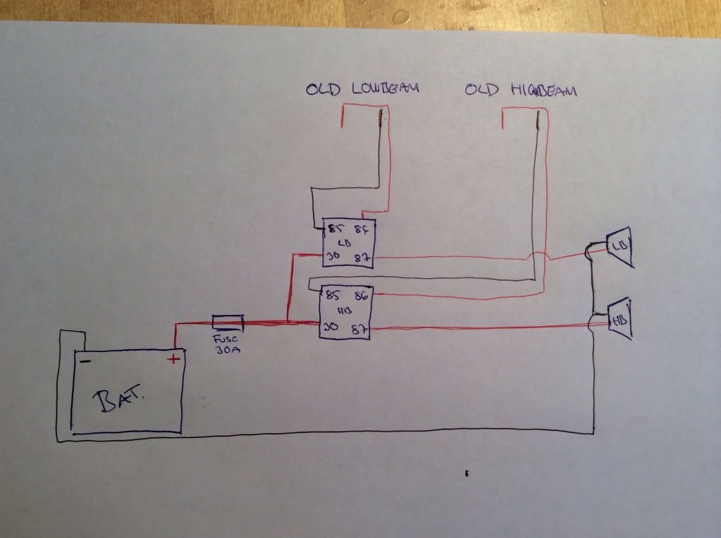

However, if i look at the layout of the mod, the new cables from the relays goes to both of the H4 headlights.. My euro-unit has a low-beam side and a high-beam side. The low-beam cuts out when i switch on the high-beam.. How am i gonna wire up the relays? Anyone done this?

And which one of the connectors from the loom am i gonna use to drive the relays? I asume the mod is intended for bikes with 2 identical connectors to the headlights.. And then it doesnt matter which one you use to drive the relays.. But im not sure what to do in my case..
OR do i use the entire old lowbeam to drive one relay and the old highbeam to drive the other and problem solved??
Jonstorp,
2 relays: one high, one low.
Yep.
Already done it.
Works fine.

Ok, so the layout should be like this then for the euro-headlight?
yes just like that :thumbup
Thank you, sir!! I really want to feel confident before i get cracking with the electricts.. And now i am!
