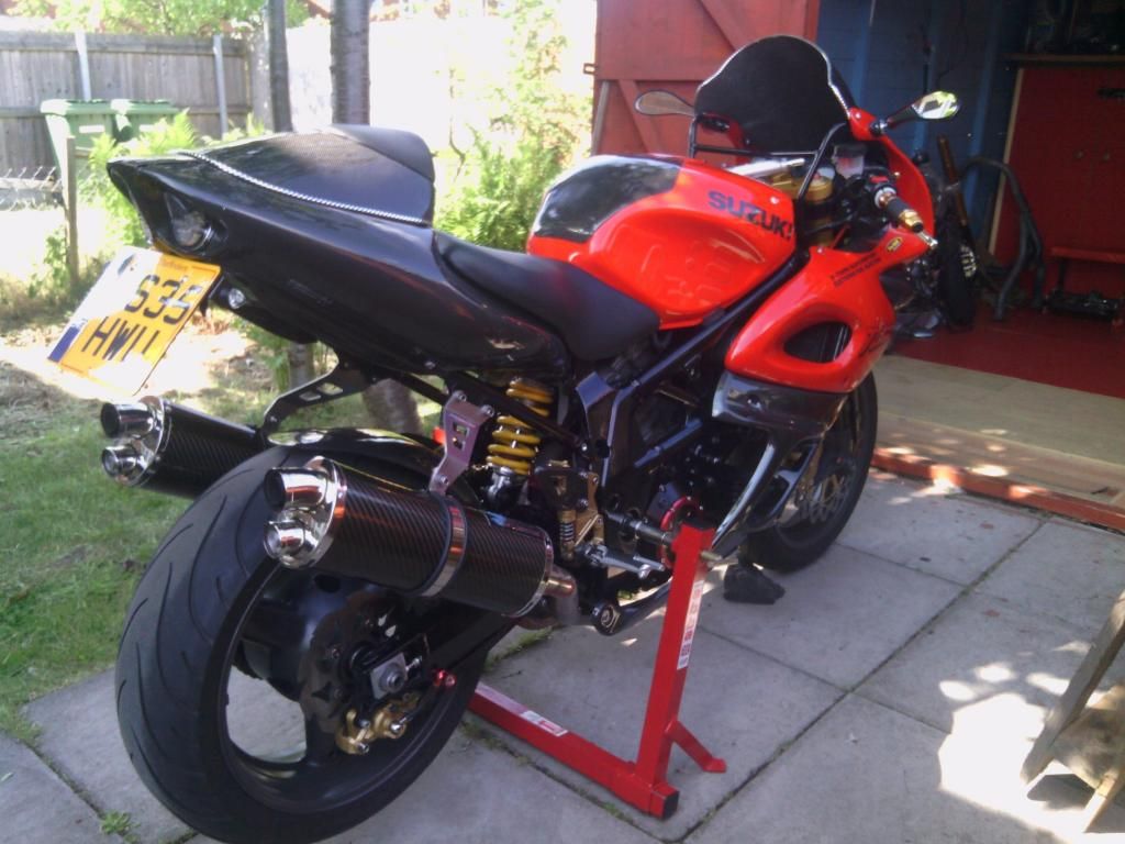

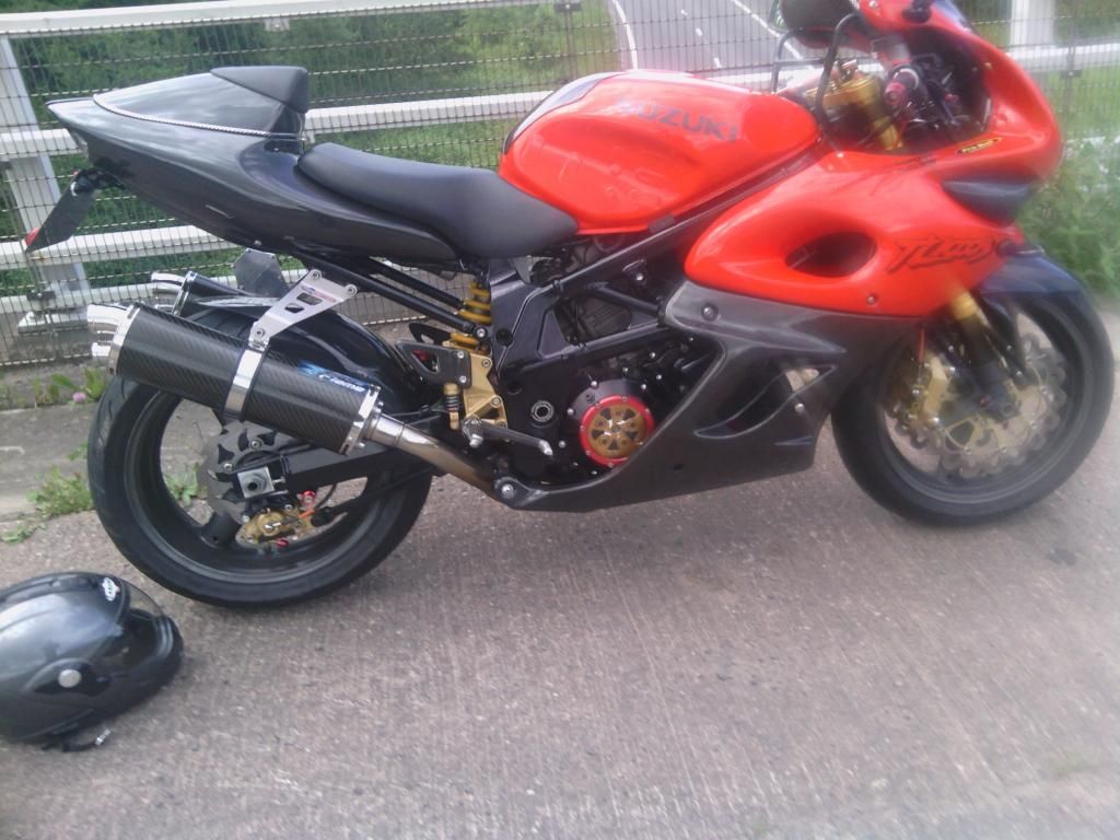

This is showa shock on my S but give ou idea:) good luck
