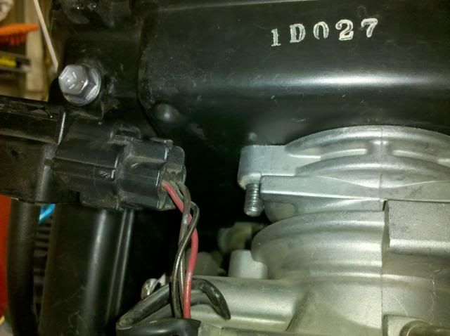

hey guys new here I have a 1998 tl 1000 R running very rich did some investigating found out that the sensor boost is shorted out does anyone know that if I take this sensor off can I leave it off or do you guys know anyone where I can get another one:hail

very rich usually means the intake air pressure sensor is not receiving an air signal.
its the ONLY hose you REALLY need
to test it just run a single hose from the throttle body to it.
Also its very easy to switch the water temp and intake temp sensors. green to green ..........grey to grey .
check them too
okay I will try its very icy in cold down here in Texas so I'll probably wait for a couple of days when it warms up a little bit morewhat does the intake air pressure sensor look like because on some models that sensor is different compared to the boost sen.
......what does the intake air pressure sensor look like because on some models that sensor is different compared to the boost sen.
The IAP or "boost" sensor is bolted to the back side of the air box. It has a vacuum line connected to it, and an electrical connector with three wires.
