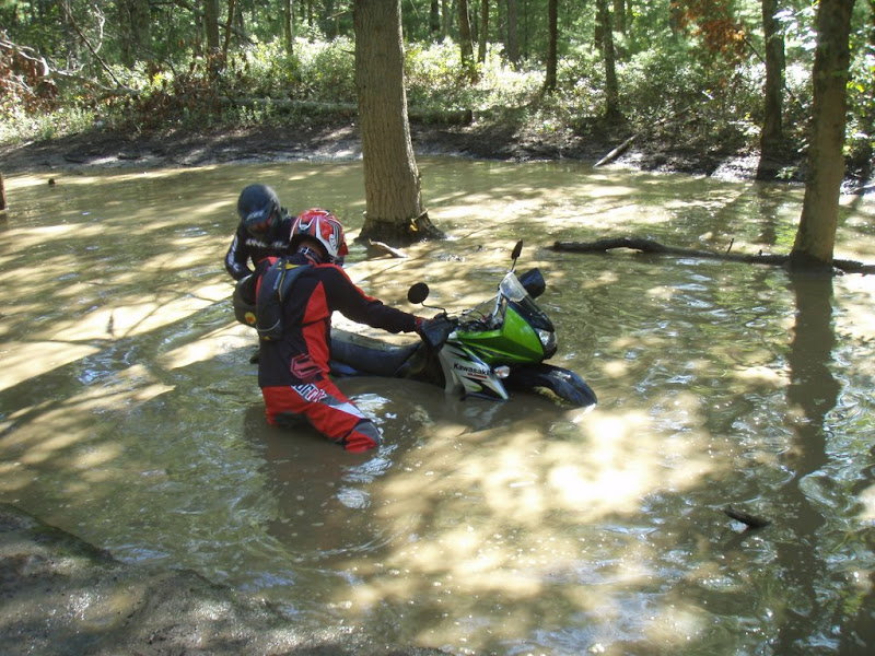

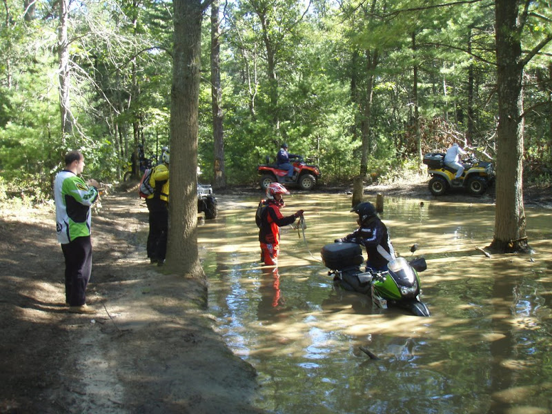

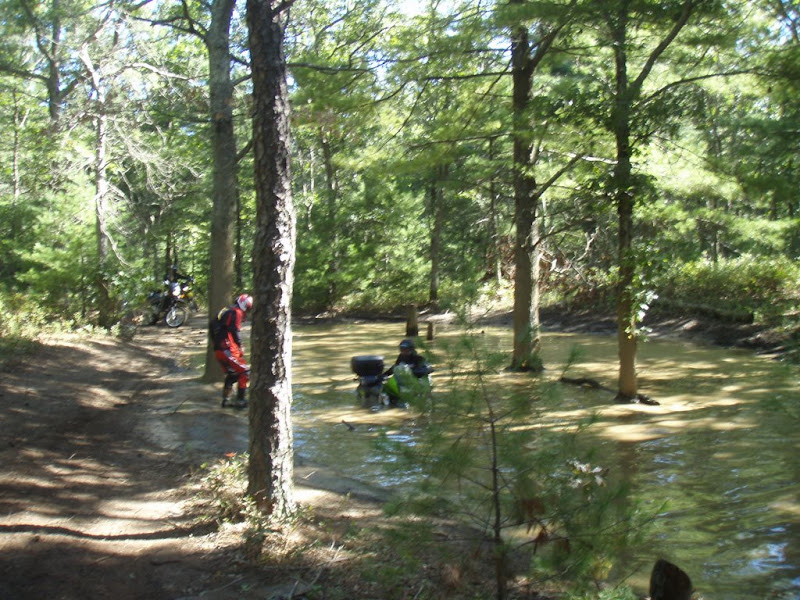

Then, not 500 yards into the ride, right where the route sheet said "warning, puddles are deep, go around" Mr. KLR decided to make like a u-boat
Which led to the indignity of 4-wheeled rescue

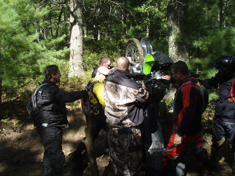

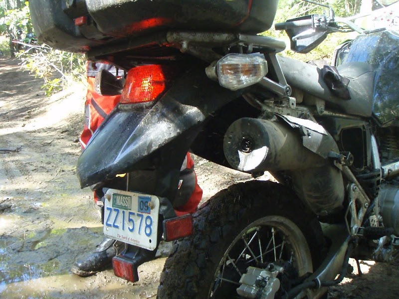

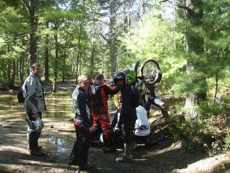

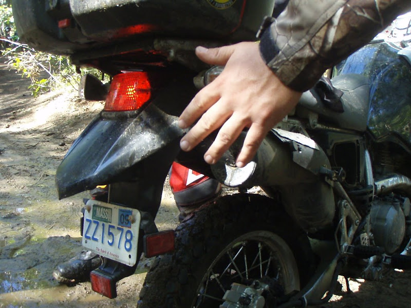

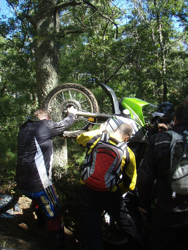

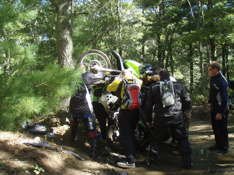

Then there were many rituals performed to coax the KLR back into life. At first there was much agnst - it turns out that getting to the plug on a KLR is near-impossible and requires removal of about everything else on the bike. For most of this procedure I kept out of the fray, took pictures, pointed and laughed. But once they were truely stymied and I began to get impatient, I said why not just roll it backwards? This was met by blank looks by most so I had to explain the basics - suck, squash, bang, blow..., since the motor was locked up it had to be in on the compression stroke with the valves closed and piston on its way up. Turning the motor over backwards would clearly shoot the offending water out the intake, all that was needed was for the intake port to be as down-hill as possible. Worked a treat.
