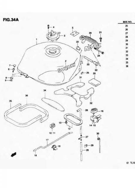

Now this TLS tank has a thick foam seal from the underside of the tank to I guess the airbox. My old '97 TLS didn't have this, but I assume it's stock on this 2000. Anyway, it's soaked with fuel! So I ordered a new seal for where the pump plate mounts. Meanwhile, I'd really like to better observe any leaks. Is this undertank foam rubber necessary? Is it replaceable? I can't find a part number for it. I assume it keeps rising heat from heating the bottom of the tank, which is a good idea. Is it likely I pulled the hoses enough to deform the plate or bezel or seal or something? I'm sure the pump plate has never been opened before. Maybe I can find better hose clamps somewhere too?
I'll drain the tank, make sure the mounting surface is flat, remove the saturated foam and install a new seal. I really need to be able to watch it under pressure and see if I can find a drip. Right now all I have is saturated foam, a real fire hazard, and I can't tell where its leaking from.

At any rate, I found these in the micro fiche that comes with the TLS service manual download. They have part numbers. It is just a matter of checking with Suzuki to see if they are still available.
Thanks! I don't know what I was looking at... With what you & zippytlsr say, and based on the fact my Illinois '97 didn't have it, I'm initially going to just remove the foam.
