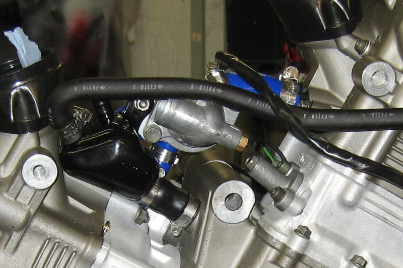

There is no oil temp sensor on the TL. Only coolant temperature. The '97 was mounted in the radiator. All subsequent years were mounted in the thermostat housing.
Only the oil pressure switch is near the oil filter.

I have same koso(rx1n) gauge, you can put water temp sensor thermostat housing. just drill 8.7mm(from my memory) hole on the housing and put 1/8" npt thread. you can put same thread oil drain plug.
