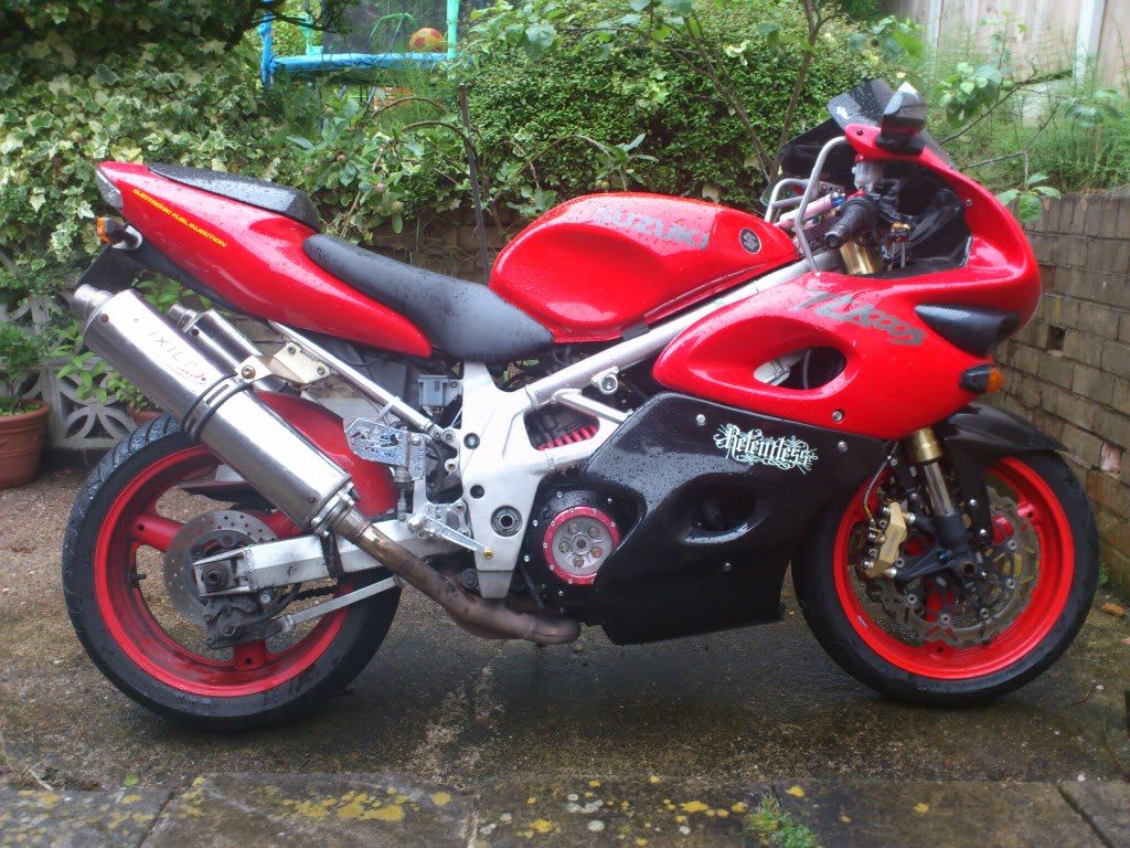

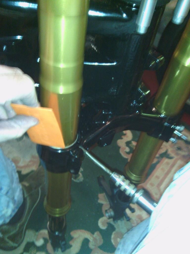

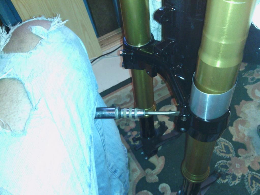

I have the 04 gixxer 1000 forks on mine Get a spacer kit from SAM, then use everything standard. you get spacers for the brake discs, which ive lost the photos of , spacers for the brake calliper fixings and the spacers for the forks. on the forks i used screw driver to hold open the bracket some silicone spray to help the insertion, and a bit of plastic and a hammer to tap the spacers in. .... the plastic did break :) but not untill; the job was done . :) i found turning in a lot better and the braking is a better as well.,

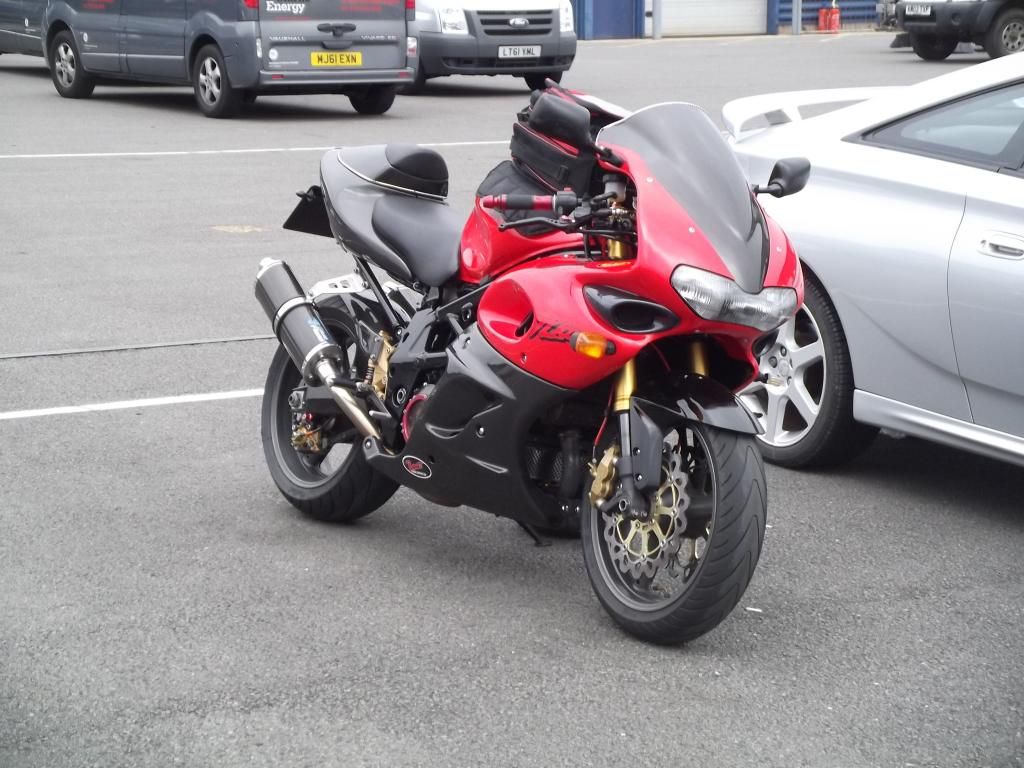

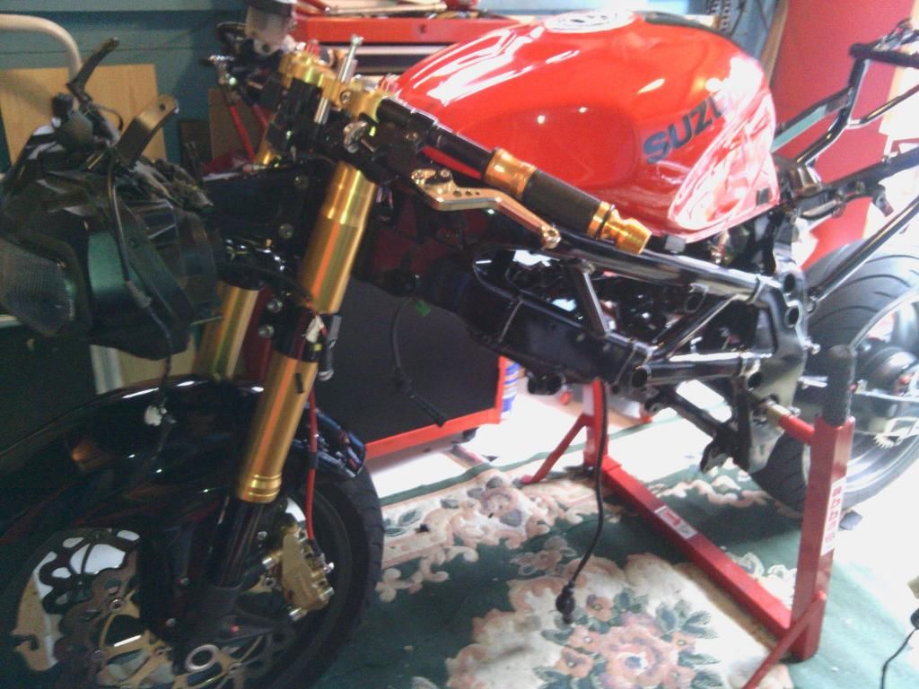

Gsxr600/750 k4/5 forks. 12mm shorter than tls. But gave no issues.
The bike handled a treat. I only removed them to help fund another project

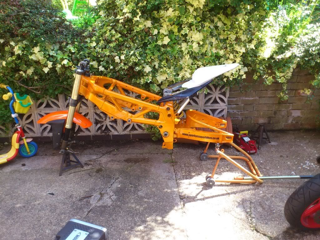

Hows the new build going Gaz ? sorry to hijack
yeah Gaz, i'm interested in your new build as well ?? are you planning on finishing it until the summer time?
Build is on hold.
Divorce hijacked my plans.
But it's going to be done this year
zx10 forks in that
