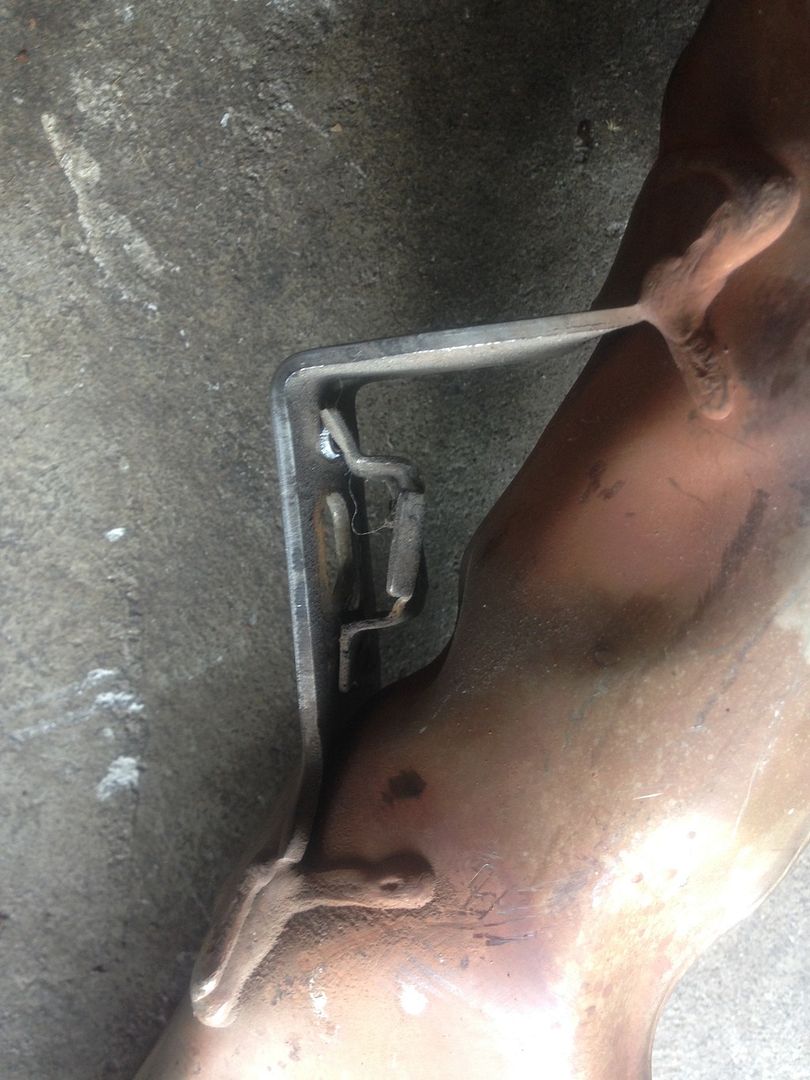

then went to put the exhaust on...not that ill be using it, as there is another one on the way from Germany....but this is an old one I had when got some cans..now I have the m4 full system on it...but when they have taken it off..they have lost the nut that sits inside and pulled the rivets...
quickly did a fabrication, nothing special..and got them on...stacked shit lods of grease in header bolts and tightened them just past finger tight....all i need is for them to fkn break again...
