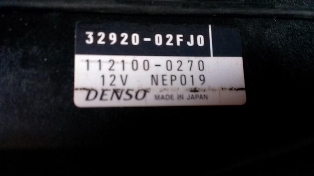

I am very curious to know which ECM your are running. Mine is part number 32920-02FJ0.
As you say, it is like a light switch. It is a 'cold map' problem. Once it reaches 176F degrees everything is fine. However, when on the cold map, mine primarily runs ratty below 3200 rpm. When the revs are higher that 3200 it runs pretty good.

Six5, we do have the same ECU!

What I still don't understand: are all 32920-02FJ0 ECM's "bad" and show cold map issues?
Armin
Armin
It is difficult to say if ALL the TLS ECMs of that model number are "bad," but there are reports from others who have experienced the same effects as you and I. They also found no resolution for the issue - yet (as far as my research has revealed :dowhat)

The new ECM (32920-02F41) made a HUGE difference! The cold map stumble is completely gone, a day and night difference!
Thank you again, Six5 for the recommendation, my TLS is a pleasure to ride now.
