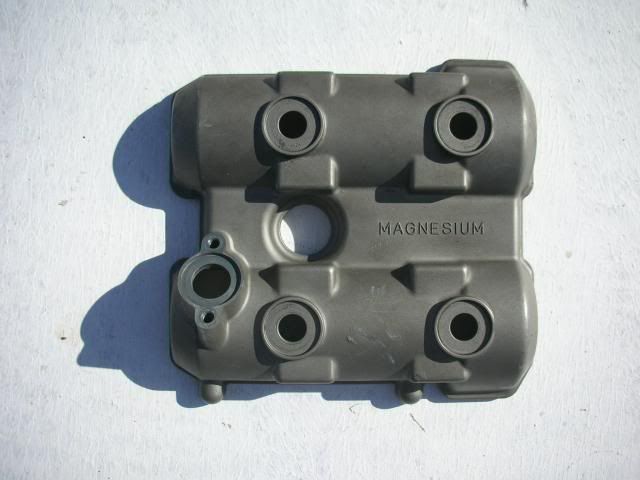

I was given a set of TL valve covers a couple years ago. Stuck then in a box until I found a need for them. Now that I am looking at them again, I notice that the rear cover does not have the vent spigot in it. It is not missing. It was simply made without a vent. So then, my question, does the lack of a vent imply that this cover is from a '97 TLS?

and the answer is yes . it would be from the first generation S .

Thanks Stu. :thumbup I figured as much, but now I have the 'official' word on it. :)

The valve cover fitting is for the crankcase breather, and has nothing to do with the PAIR.
The late-model "velocity" "D-section" ports also work much better with the PAIR than the '97 would have.
