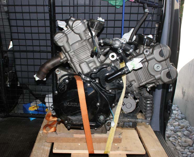

I used a one-way palette, some blocks of wood and the same clamping sets used to secure the bike in the van to have it shipped by myself in the van.
