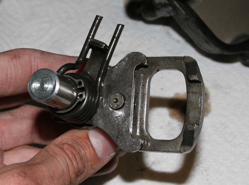

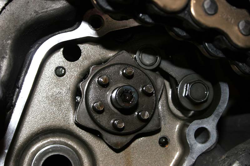

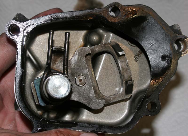

Here are some pictures of the shifter mechanism. In my eyes, everything looks OK. I can turn the shift star by hand, but only very few degrees to left and right.
I can't understand how this could happen, but it did happen. Some reading how a gearbox works:

no nasty noises when running?
clutch in adjustment?
But anyway, With the wheel in the air, use a small scrediver to turn the indent gear. rocking the wheel a little as you go. If it wont budge? got to be shift forks I'm afraid.

Ha... 133bhp beat me to it... i was going to suggest exactly what he said... if you cant move the star with a small screw driver... you'll be splitting the cases to replace your bent shift fork(s). sorry.
